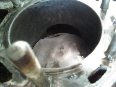

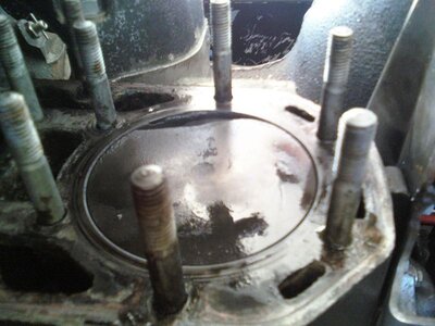

Tad lean

He ment that my boat is water shy. Everytime it goes out it gets towed back.
It over heated and melted the pistons. We are working on getting the factory 750 pipe to work in the boat. Had 2" 750 exhaust with 1.5" hoses and waterbox from 650 set up. My theory is the back pressure on the exhuast prevented the heat from escaping. Obviously the boat was too lean for the set up. The exhaust will have 2" hoses and the proper waterbox before it goes onto the water again.
