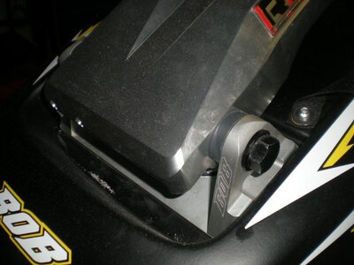

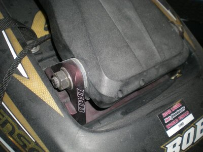

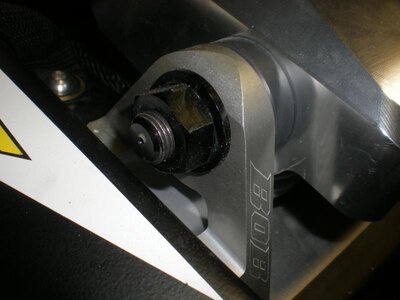

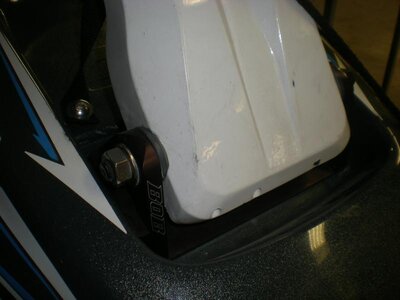

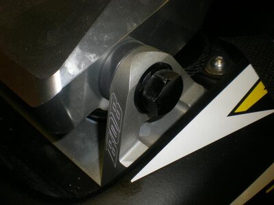

well here I am sitting with my thumb up my butt once again... I have been chasing down stupid little parts. I ordered a RRP pole bolt and its not working with the BOB bracket. The hole on one side is to small for the bolt. The hole with the threads is to small. That bracket has been causing me a lot of problems. I dont recommend buying/using one. The ski clinic doesn't document things on their site to tell you what additional parts may be needed with the part you are about to buy/looking at so I am waiting on breather tubes too.

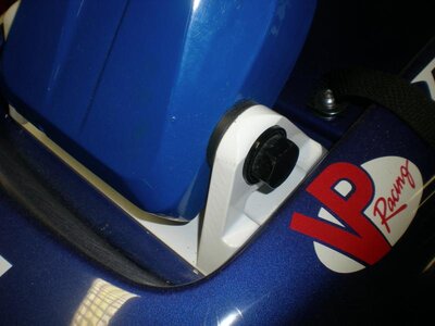

I'm sorry you're problems bolting up the bracket, certainly something we haven't heard of before. All builds we do use our BOB Handle Pole bracket & the RRP/ Blowsion lightweight pivot bolts, and we've never had to modify any parts for them to work.
Perhaps try and loosen the bolts on the underside holding the 'ears' of the bracket, allowing them to pivot? That could be an issue as they may not be perfectly straight at the moment, but will once the pole is mounted.

rubbertoe
