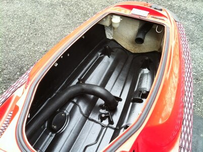

For all of you fellow OCD members who have painted the engine bay to make it look nice, what have you all used and how did it last?
I am looking at the interlux bilgekote paints that ive used in boats with great success.
I have searched and didnt really come up with any good threads about it so,
Let me hear what you guys are successfully using and it holds up.
Thanks guys

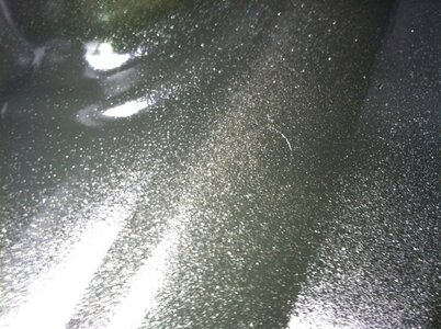

Spatter trunk Paint seems to be working great so far.

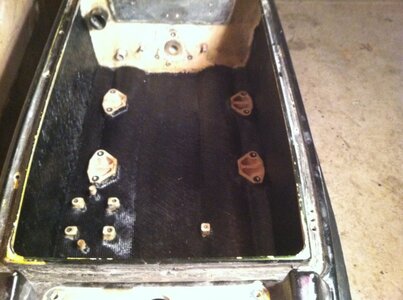

Appliance epoxy is what I have always used. With proper application it holds up awesome. Here is the black: P1000064.JPG
I have also used white on a few boats that held up just as good, very resistant to spills and stains.

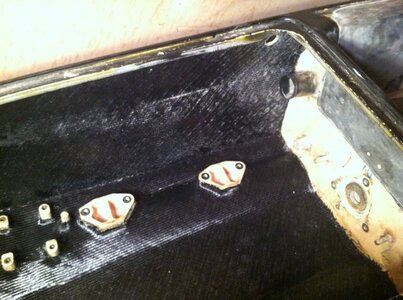

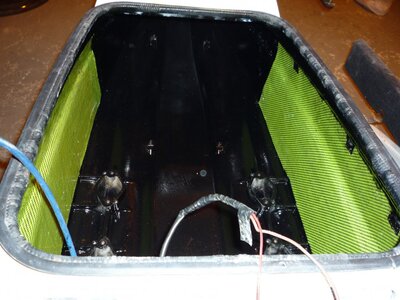

Same here, black pigment in the epoxy resin.

@Quinc yea i end up not glassing the bottom bc i got talked out of it bc they say the rn bottom is stronger and mines perfect so no need for extra weight or else i def would have used the dye and glassed as that was my orig plan

I used the duplicolor trunk spatter paint like OCD Solutions recommended. I havent tested it yet though. It sprays like undercoat with white spatter in it. It's textured like undercoat as well, rough. It's been 50-60F in my garage and in some heavier spots it still hasn't dried. Spray a few coats, the first being a dry coat as the stuff lays light and gets blown around by trying to lay a heavier coat. It sprays fine and seems to stick better to itself rather than the primer coat.
The original paint in my WDK ROK is whats called Zolatone 20 series, and thats the real deal spatter paint they used in the old days for trunks. It's probably better and more durable, but it requires a pressure pot paint gun and something with a 2mm tip. The dupli-color trunk spatter paint matched it perfectly. Im giving it a few more days to be positive it's dry and then im laying a few coats of Duplicolor matte clear. A little bit more protection and lays on invisibly. A test panel proved it to smooth out the rough texture some.
