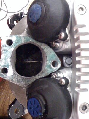

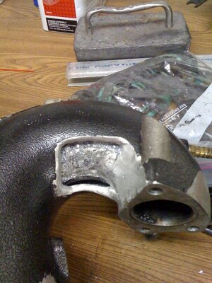

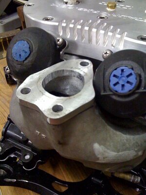

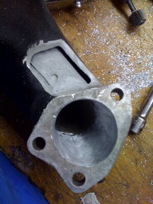

heres mine. I just cut off a section of the water jacket, then welded it sealed. I still had to make a 1/4" spacer plate to get it to fit. Actually, I probably could have got it to fit without the spacer, but I already had it made, and didn't want to do anymore grinding to the headpipe.

Any pics of this would be appreciated man. I don't see how a B head pipe is gonna clear my retainer spring....I got it to clear the plastic but no way I see on the clip.

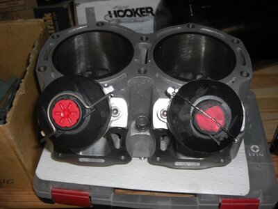

New housings use button head screws, the clips stick up too much. Want some new style housings and caps?
He doesn't need them, they are 1st design DASA billet housings, other than I modified them for bolts instead of the clips. I used to cut all your housings and weld tabs on them to make them a bolt on setup, way before DASA came out with the 2nd billet design with the bolts.

The Seadoo black caps are all the same now from Seadoo, clip or bolt, just cut off the bolt boss if you want to use the clips. (only one part # available now)
Blue or red adjusters are the same, except color. (different part #)
