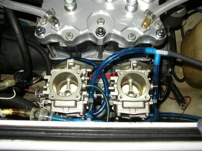

Here is how I am running my lines. 2 t-fittings and 2 straight fittings. 2 lines to the pulse fittings on the cases.

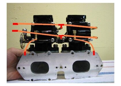

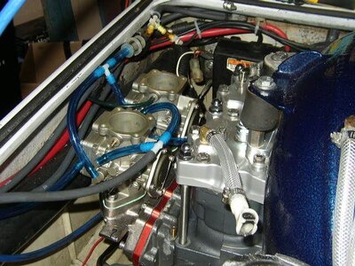

heres my new dual 44 set up. one of the pulse fittings aren't connect. i was waiting for the JB weld around the new pulse fitting to dry.
does it look right? i went with keeping the reserve line. also the primer still needs a "T"
