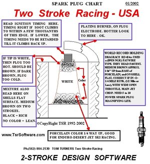

To truly do a more accurate plug reading, you need a 10x magnifying glass to really check the plugs. With the mag, you can do much more than just check color. This chart might come in handy.
