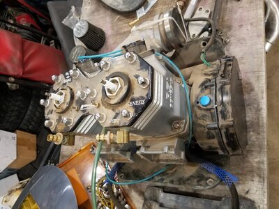

Like this? PSI performance used to make them, but getting parts is a pain. When I took this picture, the engine was fresh and never fired. I have now started it and put probably 45 minutes on it. Still trying to dial it in. It uses an adapter plate and a heavily ported powerfactor manifold to line up with the polaris ports.

@G-Body ,. I personally took those molds out of their storage in the attic and threw them out. I was looking for the molds of the Riva Red Pipe (also thrown out) and came across the PSI molds. They were no longer worth anything and in the way. That was a huge motor, you should have seen the triple.
Psi had a few difference cyl spacings from what I've seen with the Polaris based twins. Did they have a poo based spread bore triple as well? I can only image they would to use their big boy cylinders on. But then again I did sell a spread bore twin case to a guy who wanted it for a triple project, so maybe they never actually made patterns for it? Would have seemed more logical to just find a triple case, if it existed
@egbrig well thats sad. I kinda figured there was no chance of replacing these cylinders if anything ever happened, why were they no longer worth anything? Damaged, or just no market? Any idea how many watercraft motors they made? I didn`t find much info on them. Only a couple of people seem to have seen the watercraft engines. The snowmobile version seems to be much more common.
@OtherDonnieGuy I know PSI made polaris based motors and arctic cat based 2 and 3 cylinder motors. I haven`t heard of sea doo based motors from them.
PSI owed on them and to the foundry- why make them when they were inferior to the other cylinders. I've seen one or two watercraft versions over the years but they never really did anything. I must have read the PSI site write up two dozen times so seeing them in person, I was kind of awe, but no, there were better out there so just another no use mold.
