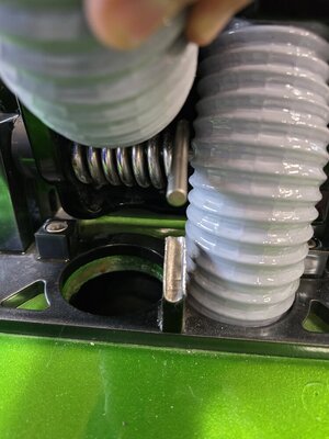

Hello, does anyone know what pole spring to run with the rrp pole? I bought this ski recently and the pole is way to heavy. I think it has an OEM yam spring but I'm not sure on that. Any advice would be greatly appreciated. It's a 03 sxr 800 hull

I recently bought a ski and the guy had the spring installed incorrectly, almost like it was pushing down, worth checking. I like to snug up the bolts a bit as well but not to much.
My pole spring is on the opposite side of the bracket than yours. Starboard side . And yours looks upside down also. I got my pole spring from Jet Manic I believe. The pole I’m running is a Watercraft Factory which is a copy of a Rickter pole.

This is correct. Remove pivot bolt, flip spring around to be on the other side (from port/left to starboard/right) of the pole, reinstall pivot bolt, spring should not be resting in spring perch correctly and holding the pole up a bit.
