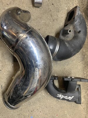

If you are talking about the stainless Pro-tec pipe below, according to Pro-tec this is their "A" pipe
I have one on my 650 backup motor, hits good, way better than stock
If this is the pipe you are talking about, let me know and I can pull up my old jetting specs
That's the pipe and yeah they told me it’s the SS A body pipe. I ordered new gaskets and mounting hardware as well as their recommended rejet kit. For 150$ I’m happy to not put a stock exhaust back on. I pulled the motor which was a first for me, not a big deal at all, hoping to be on the water by mid week. This winter Id like to buy some more parts, including a 701.

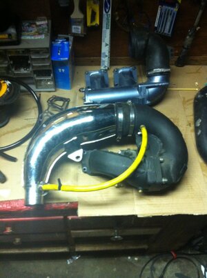

here it is, it has an ear broken off on one of the manifold mounting holes but pro tec said it wasn't a big deal

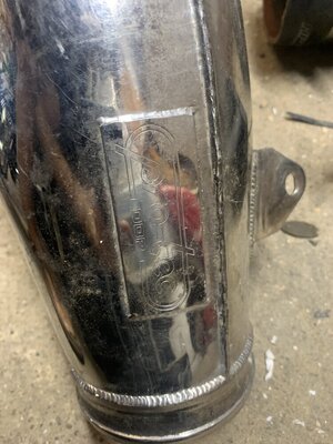

Bumping an old thread. Looking to cut, rotate and reweld an old protec DBP pipe for a blaster or raider to fit my sons fx1 with a 62t cycle. Stainless chamber and cast manifold. I’m assuming this the the “A” pipe? Protec still sells the mounts which I need. Also wondering if anyone has ran them without the lower mount on the chamber? Will be difficult to get it back in the exact spot.

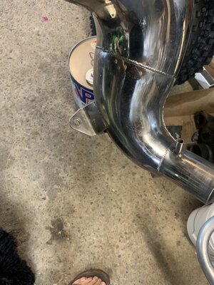

Looks like the sj pipe had the lower mount on chamber up higher? Looks like that chamber was just two stamped pieces where this one is four?
