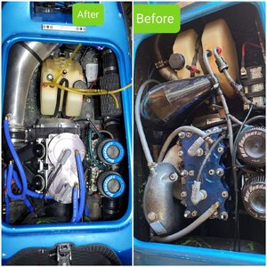

Hmm I'm considering dropping mine from a 150mm 10/15 skat to a 8/14 this next year, recently went from dual 46mm to dual 48 Novi so spent most my time getting them tuned in right this past few months
