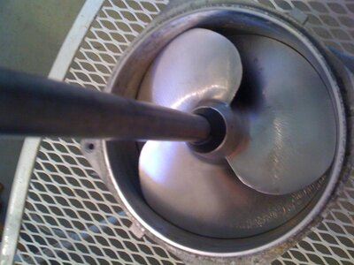

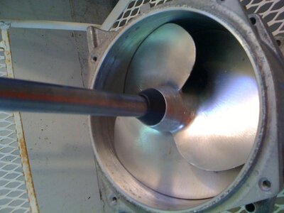

So I pulled my pump to replace pump cone with an epic freestyle cone and found water and rough bearings.
Question is which prop removal tool do I need to get this prop off....or is there something that I can rig up that will work? I do have a spline holder, so I'm guessing the rubber nose on the impeller/driveshaft gets removed then special tool is used to remove?
take out the nose boot. if it's a hexagon shape you need a skat impeller tool. if it looks like lugs under the boot you need a solas impeller tool.
it's a left hand thread as well, so with shaft held in vice with spline tool you turn the prop clockwise off the shaft.
