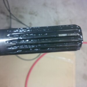

I pulled the pump and the splines on the drive shaft are all in tact, and I can verify that there was no metal particles that would lead me to believe that the female end was wearing.

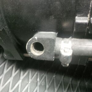

I also noticed when I pulled the pump again that the factory cooling line tap no longer has the circular insert in the end and is therefore not working(trying to add a picture). This is the factory cooling tap that faces forward, essentially the water now just gets blasted through at a 90. My pump is tapped for dual cooling on my 701 with B-pipe. Has anyone had this happen and what have you done to fix it.
Any thoughts on why I could be running into this lack of acceleration issue even though it sounds like the motor is revving up? Could this be caused by excess heat from only the single cooling line operating?
