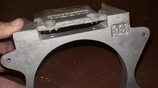

I have broken the pump shoe out of every ski I have owned at least twice so I am not new to the subject. Has anyone used the Blowsion aluminum pump shoe? I got mine today. Fast shipping and product looks good when you hold it in your hand. Here comes the but... The intake grate does not fit. The holes in the hull do not match up. And the holes that bolt done the rear of the intake grate are not tapped. Here is a pic after ten minutes of grinding. I finally decided to make the post when I saw the holes were not tapped. Am I doing something wrong? Or was mine made on a Friday? Let me know your experience or if you are planning on buying one there is a little modification you need to do if mine is correct.
it's the jet dynamics pump shoe marketed under blowsion. I have installed a few some times they come tapped and sometimes they dont, I usually just grind the grate to make it fit and you have to grind alittle on the pump shoe where it goes into the hull to make sure it fits tight against the hull. Before you glue it make sure it sits square use the wear ring and check the gap all thr around without the seal.

It gets worse. I went out to epoxy the old holes in the hull and my tools were in a puddle of water. I just refoamed at the beginning of this season. I think I am going to cry. I tapped the holes and grinded the shoe to fit. No big deal. This is just info for someone that is going to buy one in the future if this is how they all come. You need a 6 mm tap, you'll have to epoxy your old holes and drill new ones, and you'll have to grind the outside of the shoe to fit in the hull and then inside to fit your intake grate. It doesn't take long if you have the right tools.
