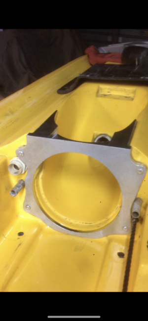

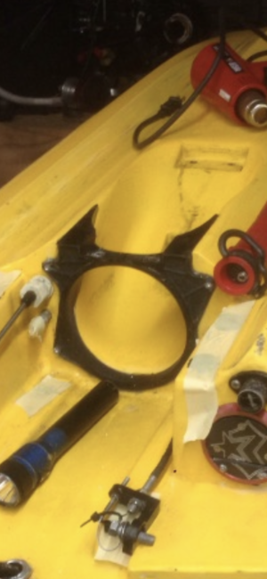

My plastic shoe was installed with epoxy. I Was nervous too remove it during an upgrade and possibly damaging the gel coat or hull.....
Turns out silicone breaks down when heated and releases and epoxy breaks down when heated To just over 200 degrees with a heat gun...
I got the shoe out without any damaged to the hull or gel coast using the heat method..
