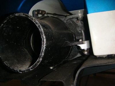

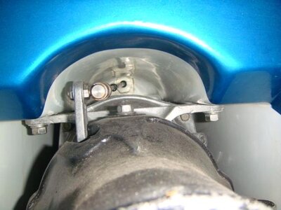

Here are a few pictures a guy sent me of his 155 he put in a 1200 blaster.
Demon, what kind of HP will the 144 handle? I'm trying to figure out what prop to start with on mine, any suggestions?

You have to increase the intake gullet size on the hull to make a bigger pump work. bigger gullet gives better acceleration, smaller gullet gives better top-end by the pump not becoming overstuffed.

My B2(155mm pump) that i ride my kid on is a regular OEM 760 but it has dual 38's and you can literally hit the gas and it leaps out of the water like a stand up. It has TONs of low end hit. Its a all stock 64X just running the dual 38s and not the OEM 44s that come stock on the B2.
If you made a huge intake cavity like CARBONX2 says on a SJ or whatever hull i think it would hit like a freight train in the low end area and launch.
