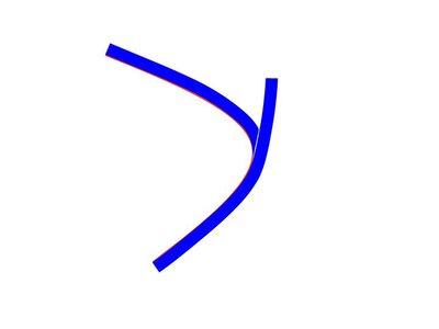

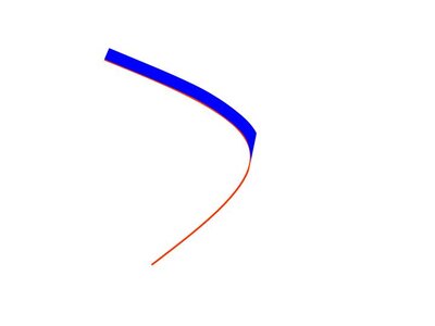

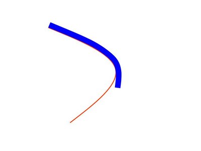

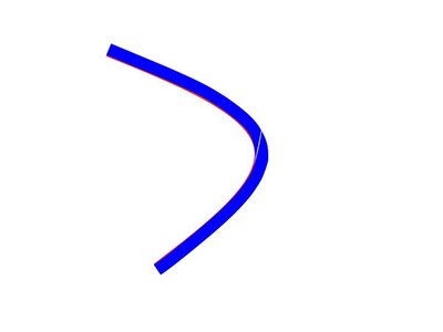

If you have the type of footholds that require a seem to get the turf over, then take a look at the attached pics for my method of a very durable, almost invisible seem. You can use this technique over the gunwhales too.
Have fun!
Edit: Nearly forgot: wherever you have to make seems, use sandpaper to smooth them over. Hydroturf sands really well using a medium grit sandpaper (and then fine if you're really anal like me!)
