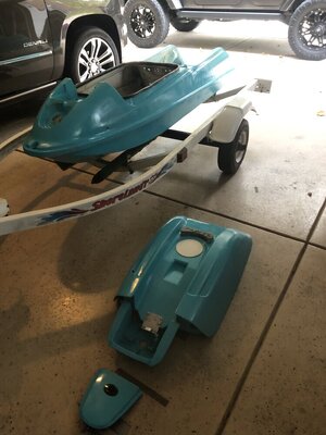

I’m gonna run a Coffman rocket pipe and the twin Mikuni 40i’s on the winter build, should I run the carbs as is with some screwdriver tuning? Or would it be better to have them jetted specifically for the pipe. If so, does anybody know the jetting and other carburetor settings required?
