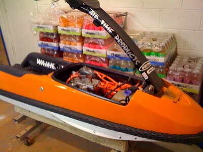

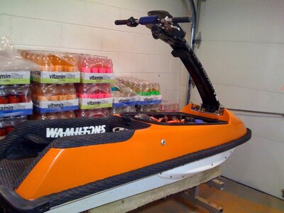

Hull:
02 Round nose SJ,
De-foamed,
Scupper Valve with ATP Scupper,
Reinforced all-over with 17oz biaxial and 7oz carbon/kevlar weave,
Filled in gas cap,
Foot Holds,
Wamilton turf all-around
X-Metal Steering set-up, -4 Pole and pole bracket,
Lowered nose piece, Lowered Hood (home made)
Orange Paint from a can.
Engine: 62T cases, 61X Cyl, Wiseco pistons, Riva 31cc Head (girdled), stock carbs (re-jeted), stock intake (filled in cross over), Factory B-Pipe.

I fill up with vitamin water that formula 50 really rips lol.
Thanks, it took a while but it actually came out really nice. They were right, its all about the prep work.
NJ
Ski looks good!
Wish I knew where to get Vitamin Water by the case? I drink 6+ bottles a day.:Banane01:
