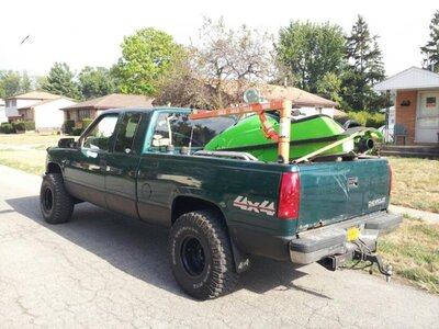

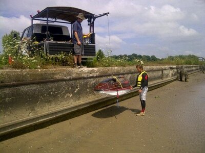

I use to use the boat launch when I pulled a trailer. Then I got the veedub. Our launch is steep, motor in the back, old brakes and manual tranny. I just dolly it down now and never have to wait anymore. The crane pulls it out of the truck and onto the low riding dolly I have. Sometimes I have used the winch to pull the dolly and ski up the sand bank when I am parked near the water. Sure beats pulling it by yourself. Really I hardly ever ride by myself but it is nice to be able to load into the truck bed and not pull a trailer. I built my crane with some vickedness yah? And a stick welder.

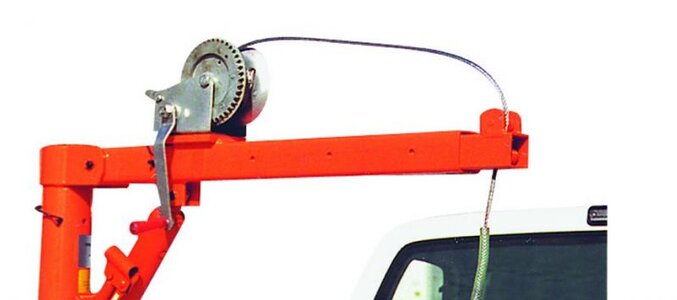

I bought the Harbor freight one for my last truck. It worked great. check out my Facebook for more pics. I used to load and unload all myself. It worked great. Especially if i wanted to bring the boat out to the beach too.

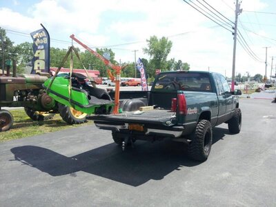

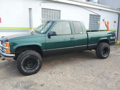

Uploaded some pics...
This is how she looks unloaded
Loading the ski into the truck by myself

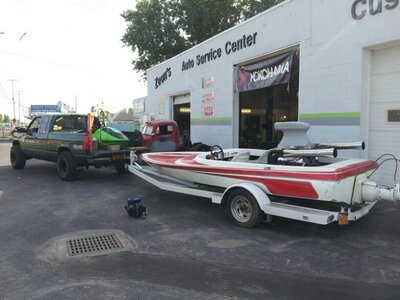

Gives you the option to still tow a trailer for other beach toys
Fully Loaded up Freeride style
Not only does the 139 dollar Harbor freight crane winch up, it also has a bottle jack which is way easier to use then the crank, and its extentable. You will need to brace it.. I almost ripped the bed floor up the first time loading with out a brace

Not the greatest pic..but this is my setup parked out in front of my house. Harbor freight lift with 1/2" steel plate on top of the deck and 5/8" aluminum plate underneath. Works great.
