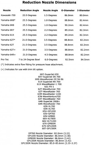

Hallo, i cant find an old tread. There were partnumbers , diameters and angles from some different reduction nozzles.
Somebody can remember were i can find it???
Thanks, Andy
Thanks, but there were an tread people write what nozzle are usable for C.A.T.S. Trim systems. Curently i have an 65v nozzle here but never heared from.
It will work????

The 65V is what l have run for a couple years and will make the ski really loose in the azz end.if that is what you want in a ski,it will work great.
