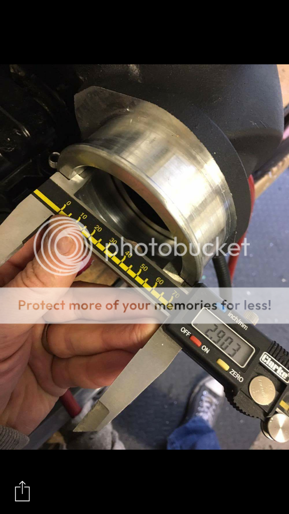

Removing sleeve RRP mani to run pfp
i really dont see how removing the sleeve will help if the carbon pipe is the same size as the ring i do believe! i have herd of some porting done to the mani and carbon pipe though
Stockton
Was thinking maybe since the sleeve
is fairly thick walled, drill and tap (3)
6x1.0 holes into the face of the sleeve and use a steering wheel puller with (3) 6x1.0 bolts and some sort of metal placed into
Manifold for the forcing screw to push against. Heat the manifold flange around the sleeeve and try to extract the sleeve
Uk
Didn't make that to clear... I want to change the chamber to a pfp, so need to remove the ring so that it will fit.
Uk
I just checked the ring and it has a wall thickness of 6mm
I'll give that a try with 5mm holes and a bit of heat.
Cheers
