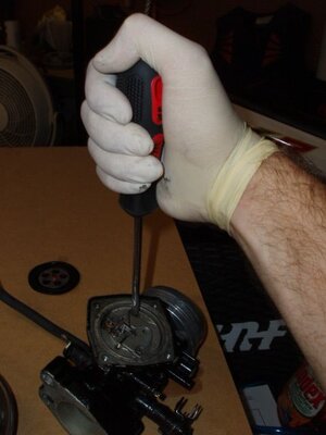

Well, I got one carb done for rejetting, but I ended up stripping the threads on the other even with using direct pressure, and tried an easy out, still didn't do crap. Had to go up to the shop and have a guy remove them for me, cost 20 bucks.
Now my question is, what size are these stupid screws? I was looking through ace hardware yesterday and I couldnt find any. Does anyone have a clue what size they are(I know they are flat top)?

Call up Jazz or Jr. Magoo's and get a few mailed to you. I always keep spares.
In the future, all you have to do is drill the head off, the block will come out and you can easily take the rest of the screw out with needlenose pliers.

i just did the same thing to 3 of 4 of mine, found the screws at sears in stainless, slotted instead of philips but no matter i don't think
