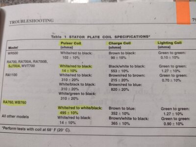

Resistance of Yamaha stator 650
For a better Bench Test of the Charge Coil and Lighting Coil, heat the Coils with a Hot Air Blower to simulate actual operating conditions.
Cold Coils can read fine, but when warm will lose performance due to Layer Shorts (broken internal windings/wire).
Yes, Pulser Coil 14 ohms.

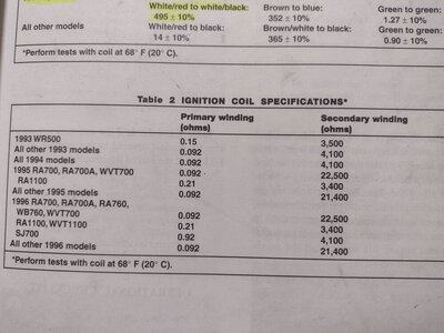

But where in the Table do you see 495 ohms????? :oops: Says 365 ohms...
The yellow highlights are not for the 650 engine.
Just read directly from the Table for the "All other models" row...
