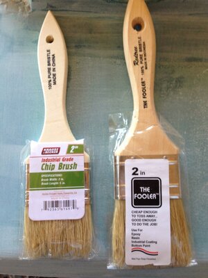

Yes. Don't use the cheap chip brushes as they can drop bristles. The nicer chip brushes are about $1.50 and don't fall apart. Cheap ones are fine for layup but you don't want to have to sand bristles out of your finish.

$0.50 harbor fright brush on the left. Great for layup, but drops lots of bristles into finish during epoxy coating. I used to use an exacto knife to pick them out while it was still wet enough to not leave marks.
Right is $1.50 brush made for epoxy. Doesn't fall apart although not a bad idea to have that exacto knife handy just incase.

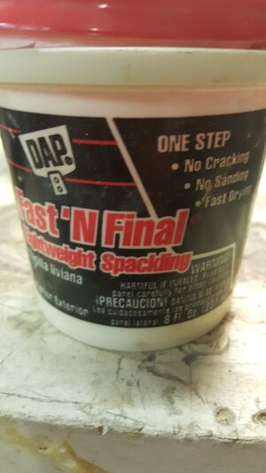

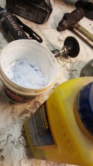

For pinholes use Fast N Final. Its not sticky or goey. Its spreads easily into pinholes with your finger. Dries fast and sands easily. It comes white but i learned from an old pro that if you tint it with chalk line chalk its easier to see where you smeared it so you dont miss a spot before your final prime.

Interesting - I am really surprised at the Fast N Final - I would have assumed it wouldn't hold up in wet conditions, thanks for the input. I got quite a bit done tonight on shaping the nose cover so it won't be too long til I start trying your guys' tips.
The only thing that should be getting wet is your clear coat. Your color coat and your primer coat and any filler or glass or whatnot should never see or touch water. Fast n Final is just for pinholes. Its a minute ammount trapped inbetween inner layers.
