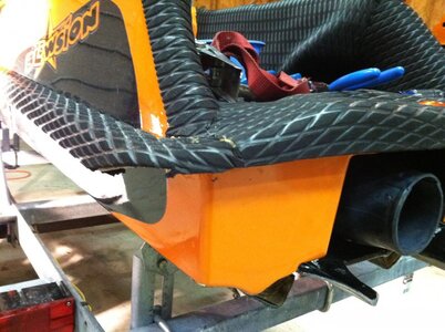

Not the best pic but I have a extended plate cut down. I have 4 or 5 different plates I have tried and I like this one the best for surf and flatwater freestyle. It lets the back end get low and still handles well if you wanted to run some buoys or something.
