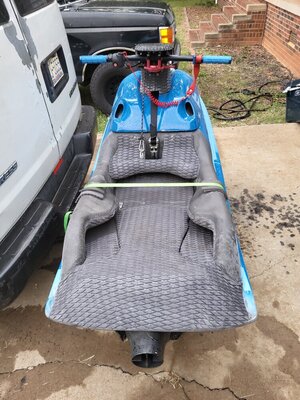

I ride both surfstance and both feet back. Just depends on what I'm doing. If I'm in the surf, or going fast and carving, surf stance it is. Hitting a boat wake, typically both feet back. All of my skis I put a front foothold on them for riding variety. My shortened, rockered superjet rode nose high so I rode surf stance 95% of the time. My superfreak I just built, I can ride both feet back and it still rides pretty flat. Get a front foothold on your superjet and you can ride whatever feels best for you. Pic for reference
