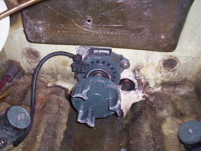

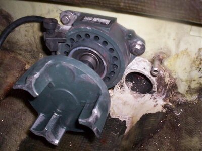

Ya, See pic, mine is pretty low.

remember if you go lower than that picture of maros there is a little bolt back there with some smc and its kinda a pain to get out...i had to mess with it forever due to lack of tools
