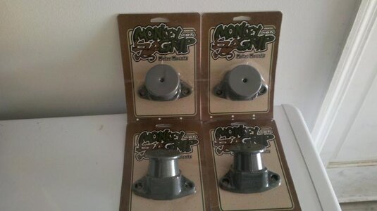

2010-08-31_14-20-27_399.jpghere is what you need bro $155 shipped for all four, raider Monkey grips. best of both worlds really, couch monut in a stronger monkey grip. This is all I run. I keep them in stock too but never had to use them on my stuff once I changed to them.
Let me know and I will ship them back to the left coast if you cannot get them locally.
