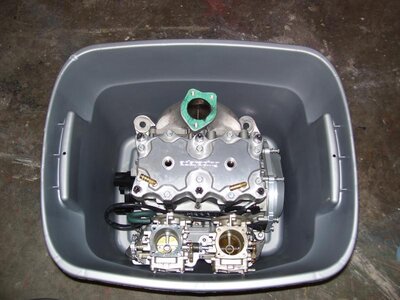

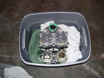

Here is how I am shipping my motor to Jetworks. Good idea/Bad Idea?? The motor doesn't move and I plan on putting more towels over the top before I seal it up. Also how much should I insurance should I put on it?

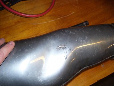

I also found that my mod chamber has been rubbing against my bed plate. Just wondering if I should have someone weld up the chamber and grind it smooth. It has not worn through the chamber completly so I dont know if I should worry about it or not.
