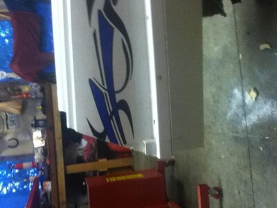

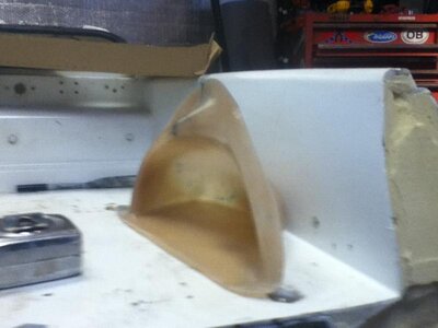

Took some pics of my hull I shortened today, and figured I'd just post them since I'm proud of what I did lol.
From awhile ago:
Shortened

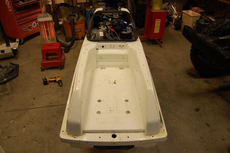

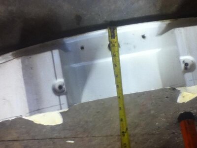

It's shortened -7" from the bump guard, or -5" from the end of the part you plane on (someone please tell me what this is, the equivalent of a pontoon or what ever lol)
We'll see how it works out. I plan to make an extended and widened ride plate to mimic the part I cut off and stop pourpoising for long rides and cruising around that I will be able to quickly bolt on.

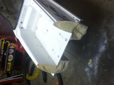

My thoughts exactly lol. I was on the fence, and decided at midnight, screw it, I can just fiberglass the tail back on if I don't like it. Just gotta pull the trigger sometimes and hope for the best.
I literally couldn't shorten it anymore, I set it up so there is an inch gap from the rear pump bolt to the end of the hull now.

wow that looks like alot. why not just leave the top deck and cut back the bottom deck? looks sweet though, you should cut the sides of the tray down, maybe like an sxr? give you elbow room. make sure you use epoxy:)
SW UT

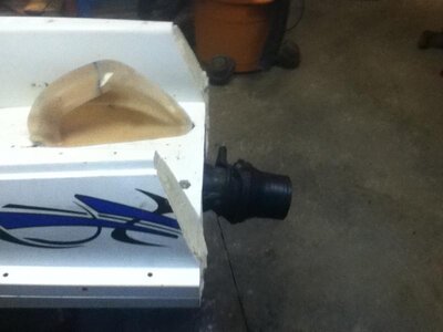

I don't think I can lower it, there's the top and bottom halves of the hull with like a 1mm gap where the tray is, so I couldn't lower it without lowering the pump. The one problem with this whole setup mounting the ski will be like having a giant tube riding under your nuts.
The nozzle looks super small in that picture for some reason, but you get the jist. Like I said, the tray extends an inch past the pump :naughty:
