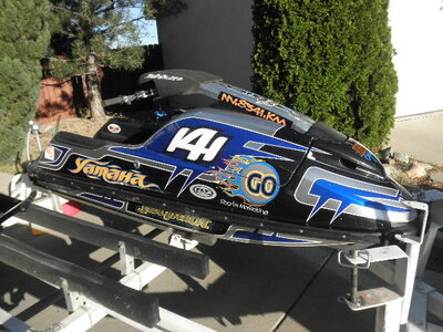

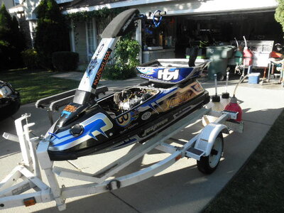

We picked up a really nice rec race RN for a steal ( i could not resist ) and i am contemplating if I should go ahead and sell the RN and go aftermarket Hull or start building it up as Freestyle ski ??
I am looking to have an alround good rec flatwater freestyle ski that also will allow for multiple hood tricks not only backflips.
What are your opinions
A) Keeping RN and rebuilding as freestyle ski ??
B) Which aftermarket hull ? If the limit is arround +- 5K ( can TEM built carbon SJ ??)
C) And what do you think the RN would be worth if I sell it ?

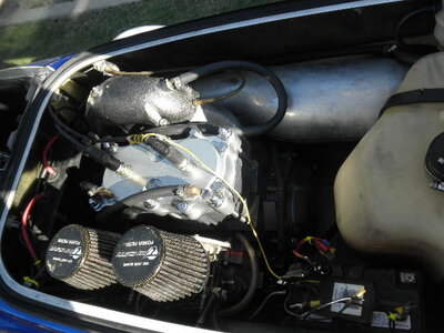

The RN currently is equiped with
62T Cases 61x Cylinder Bore size unknown compression 170 PSI both, Stroke unknown
ADA old Style girlded head cc Domes
Injected B-Pipe, looks like MOD chamber
Riva Intake manifold & Spacer
Dual 44-46 Buckshots & Dual aftermarket Tau ceti carbon flame arrestors
Reeds unknown bet aftermarket
Dual Cooled
AC pole -2 + Aftermarket Spring
Protec UP Nozzle
UMI Steering & UMI Bars & UMI Throttle
Lifter wedge Turf & Side rails racing thingis
Carbon gas cap
Electrical so far unknown, Flywheel unknown
Rule 500 Bilge & Braket & Dash Switch
Custom paint with some chips and scratches nothing major
Thank you for your input

My personal opinion is keep the RN for a while and get an aftermarket hull when you "need" that extra bit. Just about anything you upgrade on the RN will swap over to an aftermarket hull anyway so you aren't really wasting money by keeping it.
Honestly, like Kev said, Most people dont need an AM hull, they want one. You are the only one who can answer that question.
Personally, I prefer OEM Hulls.
But I would loose the buckshots. They are great for race ski's, but not so great for freeride/freestyle.

I just don't think any hull is gonna be better than the OEM setup right now, unless you want some hull to do 1ft backflips all day which is pretty dumb IMO... Plus for 4-10k you will never get that much fun value out of one if you are just a rec rider (non pro)
If money is not a consideration , after market is the only way without big HP for lake riding . It should be noted that money is always the consideration ; However , most of us should have thought about that a long time ago. No sense in being half pregnant my friend . Let's have this BABY !
