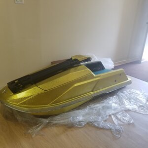

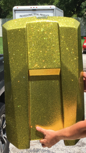

That's some nice paint on that ski
Pa
Ooooooooooooooo its so sparkly!

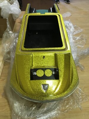

Yes its my 50cal. The latch is not the problem, it sealed great for 5 tanks or so but now its just not as snug. Yes i did the dollar test at the time of assembly and she was snug all around. Now its no go.
It looks like the way to do it is just pour enough to get good contact on both sealing surfaces all around, make sure your gaps are set up with spacers and just let it all set. Ill try it with out sanding the seal area to make it easier to remove if im not happy with the first try.
