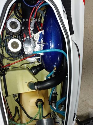

Anyone have pics of how a sj factory dry pipe fits by chance? Not afraid to modify the hull a bit. Just curious if someone has done it and has a pic. Thank you!
lucky for me the work is all done . all i do is ride it an ride it. if by chance pipe needs to come off, its less than 10 min job.man that looks like a nightmare to work on haha
Yes a B1 hullin a blaster hull correct? or...
Factory dry pipe.There are at least a dozen dry pipes. Which one?

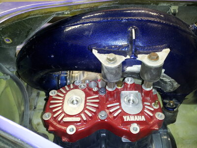

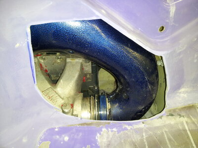

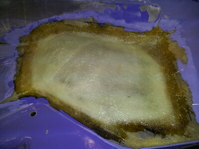

Everyone fits except for some need hood clearance. Some people like to clear the back a touch to wash removable but they all fit without issues if done right.
Rn/sn factory dry pipe chamber.Factory dry pipe.
Thank you! This is exactly what i was looking for!see how this was posted in the blaster thread...this is how i went about it.
