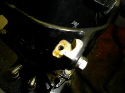

Here is a picture of the cable coming out of the pump side. I turned the siphon tube into the new overboard line. I had to drill a hole through the pump mounting bracket for the cable end to run through.
Sweet looking ski! Do you notice a difference with the back rail cut flush? First pic post #18
