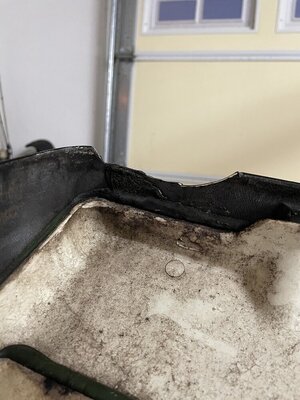

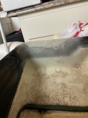

SN Hood Repair
Best way to repair this: go!

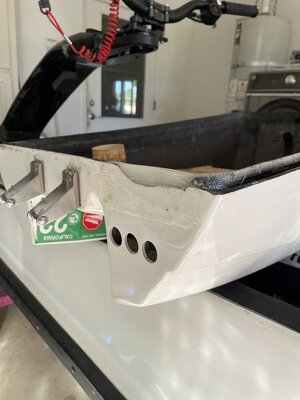

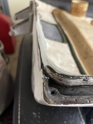

I’m a little bit retarded when it comes to fiberglass

For a quick fix I would grind it from the inside and taper it toward the outside with a shasllow taper on it going into the old material at least an 1 -2 inches the more the better, then get come cardboard and duct tape or packing tape , cover one side of the cardboard with the tape then tape that to the outside of the hood with the pretaped side facing inward , the fiberglass won't stick to the tape , now you have a mold of sorts to lay the glass against , mix up epoxy resin and start laying in pieces of glass , you start with a piece slightly bigger than the broken area the continue with larger pieces each time, with 4OZ glass you will need a good 6 to 8 layers of glass , don't worry about it sticking out on the top past the broken area you cam trim that off with a grinder later.
The key thing to take away from this is the repair needs to extend into the good fiberglass at least 1-2 inches on all three sides of the repair as that is where it gets its strength from , of course that means it needs to be ground back the same amount.

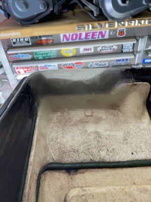

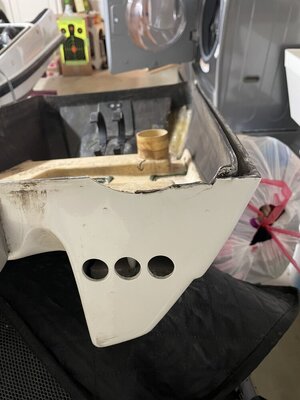

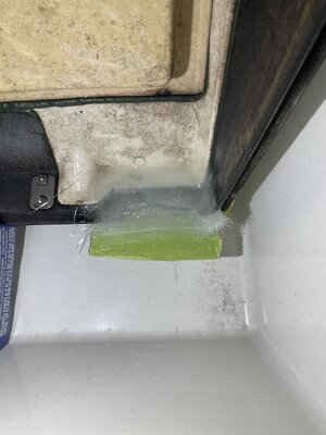

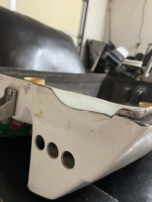

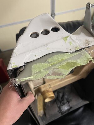

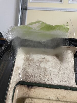

Well got some glass down, think I had 12 layers of cloth on it. Got it trimmed down and rough sanded. Need to fine tune and I’m going to lay a few layers on the outside of hood and get the profile a bit nicer. Not liking how it’s sitting on the hood seal.
