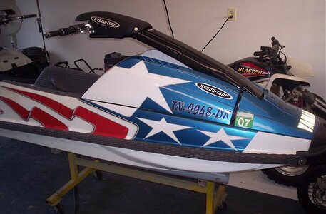

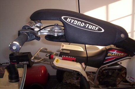

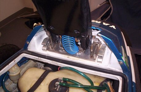

You have to relocate hood hooks on hood and hull and fill in all old holes. Then use a Wamilton or X-Metal pole bracket w/ any RN pole. I did it on below boat.

Or use a limitter rope as I do and run it. The Wamilton's bracket allows more extension then stock, UMI, R&D, Blowsion or any other billet bracket. I do stabs on the boat shown above and have come out of footholds allowing 195# of force to hit this pole and it is still going. There are square to round brackets made out there that will run $200, this would be the easy way out and probably cheaper to in long run. I think its LegDrag that had them???? Or maybe Steve802????

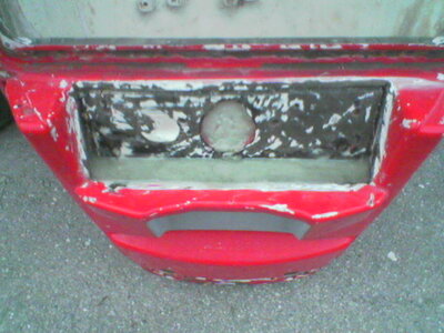

Or do as I'm doing, and modify the SN bracket platform so it is level and will accept a RN Bracket and pole without modification to the pole/bracket.
:biggthumpup:
Rickster
Matakana Menace
Sorry about the crappy cell phone pic.
I cut out the entire bracket mounting area leaving just enough by the hood seal that I could bend it down straight. I then used 100 mile an hour tape to form an area behind that will support the milled fiber/resin mix that I used.
This is the first pour, then the ski will be laid flat and all the holes on top of the mounting surface will be filled the same way.
I will then use 2 layers of 1208 biaxial on the surface of the braket area, and 3 layers of 1208 behind along with 1 layer of 6.5 oz carbon fiber.
This will be strong as hell, and will accept a stock pole breacket without modifications or limitations on the height you are able to get from it.
