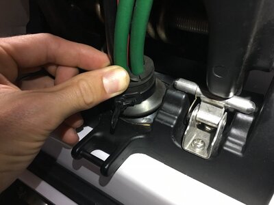

No the pipe it runs thru right before the pump I have just heard some people say make sure you put more silicone in the hole after putting a new cable or it will leak.
On the thru hull fitting in the pump tunnel there is a rubber seal the nut compresses to make the seal, if it's bad or cut replace it. As an extra precaution I use silicone on the inside of the hull where the cable goes into the tube.
