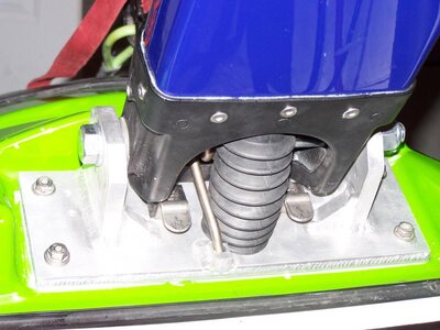

or you can contact ski-innovations.com they make a conversion bracket

The conversion is well worth it IMO just don't use a RN bracket. Do the washer thing or get the conversion bracket. With a RN bracket you have to relocate the hood hooks. Also with a stock RN bracket the pole won't go all the way up. SN poles are so freaking ugly, heavy, and long. It completely changes the ski for the better both looks and handling.

Just do it! Order the conversion bracket and get a RN pole. I went from a stock SN pole to a -6 setup and it was the best thing ever! Just do it you wont regret it!

I think I paid around 100 bucks for my pole, and my bracket would be around 150. Not sure how much ski innovations is charging for theirs. But it's still a relatively cheap mod.
