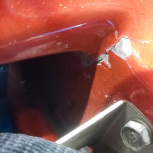

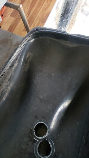

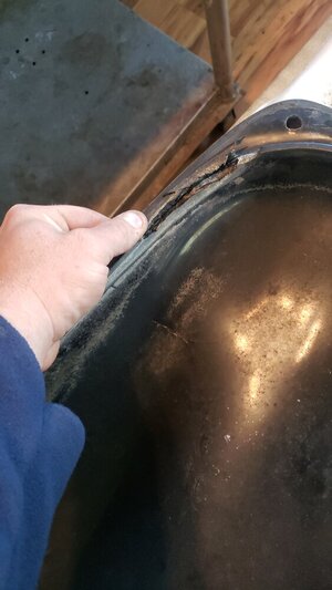

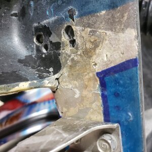

9E773C4E-3679-4AE5-962B-DEEDBBE13728.jpeg72472396-70BE-4F99-9627-3B4D77519028.jpeg119B4C5F-201F-4A18-BAC9-88DB5EB346D5.jpegF0101C1A-6A98-44EB-94BF-74426D8CA26E.jpeg
The front corners where hood latch brackets are the worst, the cracks are deep.
The entire ski is being painted,
and I was aware of the clear coat spidering, but I’m now being told by the body shop that it’s structural cracking. I’m just trying to figure out if it would be in my best interest financially to source a new hood as compared to costly repairs that might not last. Seems as if getting a new one may not be a easy route!! There is also extensive issues under the hood that could be repaired for extra of course

I almost bought that ski before I bought my carbon titan pro. That is all easily fixed with paint and some resin/reinforcing..

Personally....I would sand the cracks and fill with cabosil/resin and sand it smooth again myself before paint. I highly doubt sourcing a carbon hood will be cheaper than that...those hoods were like 1200 ish new if I remember right...there are a ton of people on this site more experienced than I am with fixing carbon I would wait for them to chime in but I don't think any of that is a big deal. I had a crack in my exhaust tube I chopped up carbon fiber since it was so hard to reach and filled the crack before laying a piece of carbon over it for reinforcement, thing is nails now.

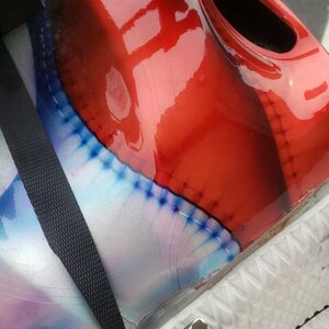

This is the crack on mine. I'll use some cabosil and resin to glue it back together then I'll sand it down enough to reinforce it with some twill carbon or glass. The way the twill is stitched allows it to lay down in curves and weird shapes without having to cut the cloth to fit around the corners. Then once its cured, sand and fair it out. Prime and paint. 20210401_154328.jpg20210401_153939.jpg

My hood has the same exact issues too

Any superfreak hood will fit. They are all interchangeable. I have repaired damage like that before myself. Fill and then loads of carbon on the back and use a long aluminum backer plate after the repair to spread the load across the entire front of the hood instead of just the middle area.

Just have the hood repaired, that is not bad damage. Way cheaper and less trouble than buying or making one.
