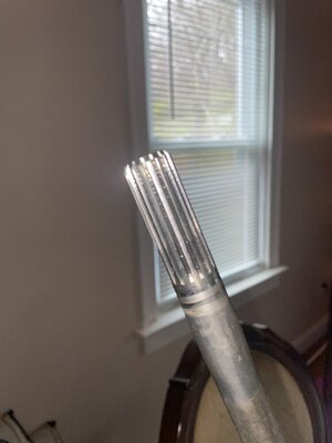

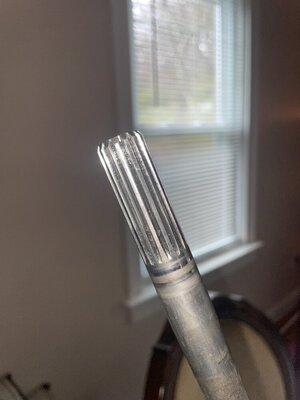

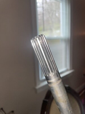

Yeah, but what damage was done to the midshaft splines? To be safe, I would replace midshaft and drive shaft....... Would suck to spend alot of time getting straightened, only to have strip out later...
I have my midshaft packed with grease already so no pictures. But there is minimal wear on both. Had a friend with a lot of SJ knowledge and experience look them over and he suggested straighten and run it if I can. If I had unlimited money and time I’d agree with you and replace them both, but I work out of town for months at a time would like to have it ready to go for when I get back from this next job.
