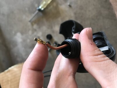

Does anyone know where to get this special terminal (see picture below) from the switches inside the s/s housing? One of those terminals broke off and I’m looking for a place to purchase some. I don’t want to buy the whole switch since mine is in excellent condition! It’s from a Yamaha Superjet.

Picture uploaded. I’ll try him.

If you’re referring the whole switch as the complete s/s assembly, then no I don’t want the harness. My harness is in great condition. It’s just one tiny terminal. When I said one switch, I meant one of the three switches inside the s/s housing. I don’t want to buy a whole new harness to replace one broken terminal.

It's manufactured as a three-switch harness assembly by Asahi-Denso. Yamaha doesn't offer it any "smaller" than the harness.
The wire could potentially be repaired by clipping off the wire, opening up the terminal crimp and re-crimping over a fresh section of wire. I'm not aware of anyone selling replacement terminals. They're likely made in-house by AD and not sold as separate parts.

I spent countless hours a few years back trying to source those little guys out and I never had any luck at all.
Like 37 mentioned above, you may be able to patch one together with other pieces.
