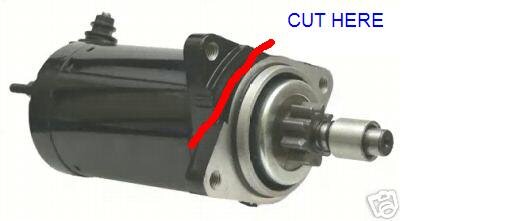

and if the starter is bad and u know how to use a hack saw then i would recommend getting a sea-doo starter off of the 800 motor and cutting the ground tab off of it. it will spin the motor over allot faster, it starts my mod 474 like right now.
i posted a picture of where to cut on the starter if u want to go that route.

Thanks for the info. Turns out there was a starter on it that wasn't stock. There were no back bolts but it had some kind of sealant on the front probably because it had no o-ring. We took the flywheel cover off and gave it a few taps with the hammer on the starter shaft and it popped right out. Right now I have a starter in there out of my stock 550 but I might order one of those sea doo 800 starters and put it on this ski since it is modded and takes a few seconds cranking to get the ski going. Then I can just put this starter back on the other ski. Just to be sure, any of these will work right? Ebay Link
ya those should work u just have to cut that tab off. i have never been a fan of the after market starters, it just seems the oem ones last longer, so i get mine from my buddy that owns a pwc shop and take them off junk ski's
