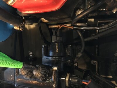

I hate the ebox connection to the stator. It never seals back up well and I always ended up removing the entire ebox to fish the wires out.
Here I upgraded to some cheap deutsch connectors. So much easier now if I'm removing the motor or need to test the stator.
