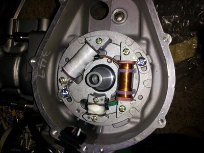

How do I tell the difference between a 61X and 62T stator?
wanderer1 Location Cruising Around Feb 24, 2012 #1 How do I tell the difference between a 61X and 62T stator?
camojoe Location In the surf Feb 24, 2012 #2 This is an aftermarket 61x. Post a pic up and I will tell you what you have Attachments Stator plate.jpg 68.2 KB · Views: 92
Marcgraham27 Location Hamilton Ontario Feb 24, 2012 #3 On a 62t stator the wires leading into the coil packs enter from the top, 61x enter from the bottom
Marcgraham27 Location Hamilton Ontario Feb 24, 2012 #4 ( in the picture above, Im talking about the brown wire leading into the white coil )
