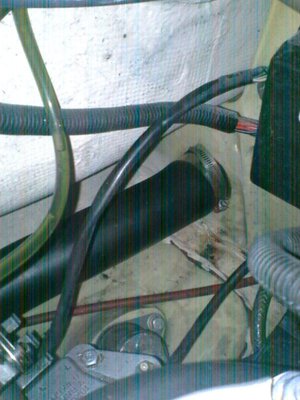

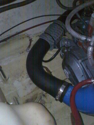

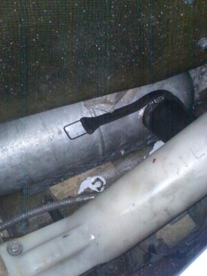

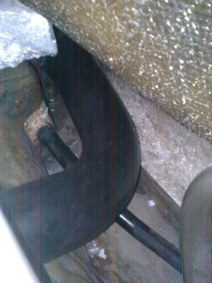

I put a 701 Raider box in mine. I relocated it under the battery box on the right side.

nice relocation...i have one out of a wave venture that looks the same...mihgt have to get one of the local blaster riders to try it!
It is a definite improvement over the stock box. I have to admit that I was impressed with the results. There was a good added low end punch that continued through the mid range. I did not notice much with the top end, but who cares anyway. The pipe seems much happier with this set up. Can't explain why, but I'm happy!!
