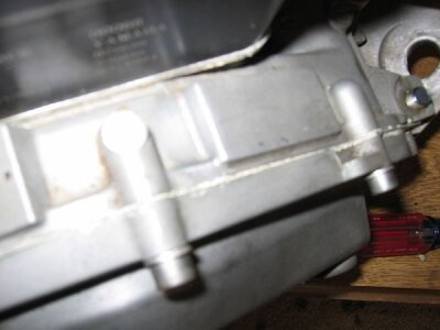

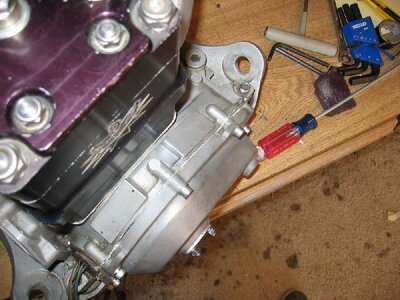

I pulled the flywheel cover and the flywheel was a little rusted and it looked real nasty in there. Seems someone in the past broke a tap off in one of the flywheel cover bolts and drilled one of the dowel pins out and tapped it for amearican threads. Then I found a crack in the cases going from the top of the case by the flywheel cover strait towards the cylinder.

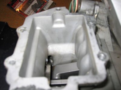

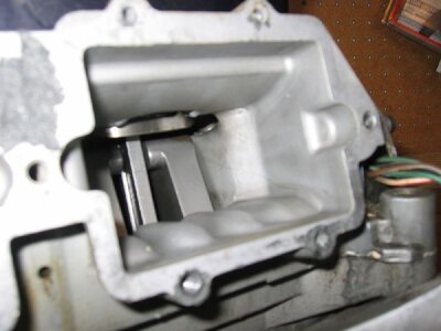

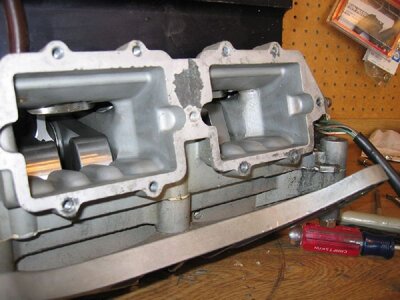

Today I was stripping the motor down to get it ready to ship and I found more cracks in the intake tract! They do not look repairable! poop
So now I need to decide whether to Try to get my money back on the motor or buy new cases and have them modified for the stroker crank and cylinder.

Any ideas? Attached some pics but cracks may not be visable.

I can't see the crack on the front side, but the ones in the intake track look pretty bad (if they are indeed cracks and not scratches).
I don't think you'd want to weld all that up, it'd be a lot safer to start with clean cases and get them ported.
Do you have any pics of the bottom side of the cylinder? I'm just curious what the porting looks like.

I have not pulled the cylinder off the cases. Wanted to make a decision on wether to keep it first.

I agree with Mile, because of all the cracking & not knowing where other fracture points might be hidden, best to replace them.
