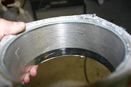

thanks for the info. next is the wear ring...how does is it come out? anyone got a spare wear ring 4 sale? mine had an appetite for sand.

it isn't warped...worked up until i beached the thing in the fall for the last ride. u guys think that ring still has some life left in it? how would you guys buff this thing out?
