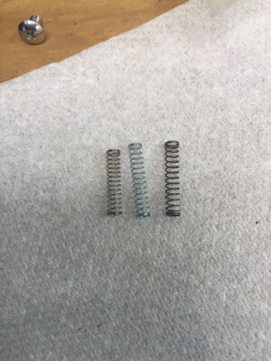

Neither of the springs that came in the kit match the existing spring. Spring on the right was in the carb, gave a pop off pressure of ~50. I installed the dull silver spring that came with the kit and got a popoff around 25.
Since it ran very well before this issue, it seems like I should stick with the spring that has been in there for years?
