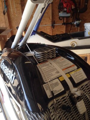

So far i have accomplished installing the new pole and modifiying the stock chin pad to fit, but not sure if i really like the all white pole or the pad. I might run some black turf on the center part of the tubes just to break up the all white. What you guys think?
Just got done pulling off the turf and side rail caps and now trying to figure out how to install turf where the caps where. Its not as smooth and clean as i thought it was going to be so do i glue some foam and shape that before turf or reglass to clean it all up? i don't want to buy the caps from blowsion.
Ok ill post up some pics i have to do it off my phone cause i don't have any on my computer.
