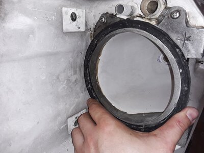

Superfreak pump seal

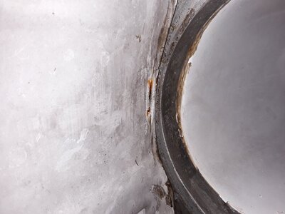

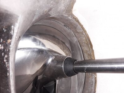

How on Earth is this supposed to work?
superfreaks don't even need any pump seal.
the pump on my first freak was just about to fall out the back before I noticed it was even loose.
the steering and trim cable was the only thing holding it in.
it never cavitated or missed a beat with a huge gap everywhere.
I think the open design of how you can look into the pump from the front of the boat, makes it hook up despite the seal.
as to your issue, yea the hull build quality is total crap.
Yes the bore is right at 144. It did appear to be a little but misaligned upward tighter to the top than ideal, but I don't think it could be moved down enough to clear a seal.
I'm debating between grinding the seal mostly through and silicon, it just skip the seal altogether and silicon.
Or bite the bullet and remove and reinstall the shoe, but that seems like a lot if work to not solve the problem.
Stockton
A pump I bought came out of a freak and it used silicone, no seal

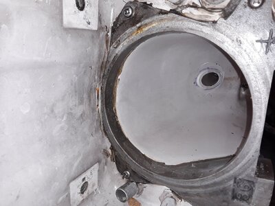

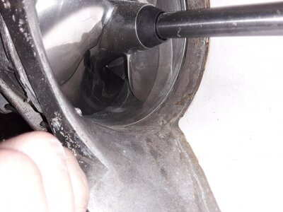

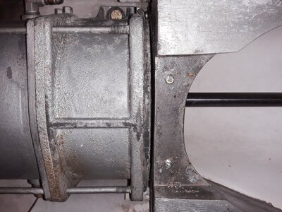

Edit: Is the ski upside down? Can you set the pump in and see how square it sits to shoe and how the bore aligns?

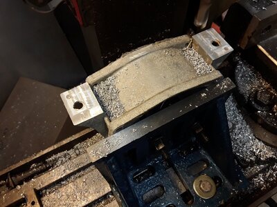

I have it on its side so I can check alignment at the midshaft while playing with alignment at the shoe. It's all round in general not a great fit. I already shaved the mounts on the wear ring to get the pump further up to line up with the bore.
Stockton
That all looks pretty good so far with what you've done. Iam starting to wonder if your idea to grind the seal might actually help. Some silicon too help seal it.. your seal idea would help with that gap too
I ended up grinding an old seal to fit, it's going to have to kind of get crammed in there but I have it test fit right now and with some persuasion it goes together. Will be using silicon as well. Not quite ready to put it all in for good right now but I think it will work.

Hornedogg and l spent the better part of couple hours getting my 148 shoe to work.lt looked like your picture.we ended up grinding the glass down at the top of the pump box in front of the shoe to fit correctly.

I used a pump seal that I ground (sanded) flat on the top to fit, and also ground into the carbon hull for fitment on my Freak . Also elongated the bolt holes of the pump and used a ratchet strap with the ski upside down attached to the bow eye with all four pump bolts installed and loose , crank the pump tight against pump shoe then tighten the four bolts I dont want any air with maximum hookup.. . Also a tip from JM use 5200 on the pump seal to the shoe. and grease the pump and pump seal to make disassembly easy and makes for proper pump alignment if you ever take it apart next time. I now have a 148 pump in the ski now and it just barely fits but know it dont slip much at all .
The seal shaved on top to fit and silicon seems to have worked, got the ski together and rode it a little over the fourth. The problem now is that the tray keeps filling with water. I have a few theories but haven't had a chance to dig into it. I'm suspecting the coolant lines are corroded through.
